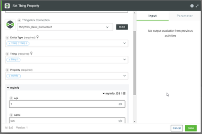

Hi all,
Anybody used Thingworx Flow "Set Thing Property" Action to set parameter of Infotable type?
Seems like it could only be used to set basic types like string or number?
Any ideas of how to use it for parameters of type Infotable ?

I tested in TWX Flow 8.5.3 and it is working on my side:
What version are you using?

Hi Raluca,
I'm on 8.5.4

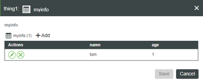

Issue is if input is infotable (and holds multiple rows) it's not possible to map it as infotable to infotable.
I cannot see input in your silde.
Pls see attached screenshots.
Many thanks,
Andrey
I have added infotable as input for set property and I am getting the following error in Application.log:
"An Invalid Property Value Was Sent To [thing1 Property: [[{"name":"tom","age":1},{"name":"jerry","age":2}]]"
Can you see same error in Application.log after running flow?

Hi Raluca,
I don't see this kind of error since I use input as an output from provious service that runs smooth.
The only way to do mapping is to derive single parameters one by one from input and map them to aparameters of manualy added row. That's not a solution for sure.
