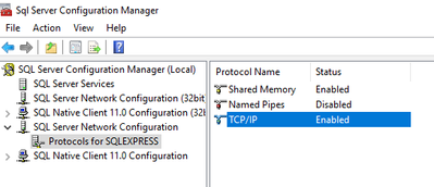

You may have already checked this, but I have seen that error when the TCP/IP protocol is not enabled for the SQL server. The SQL Server Manager tool doesn't use TCP/IP, but JDBC does, so the test to connect with SSMS may not be a completely accurate test.
Load up SQL Server Configuration Manager, navigate down to where it says "Protocols for <INSTANCE>" and then in the right pane make sure TCP/IP is enabled. By default it isn't. I believe you need to restart the SQL engine after making that change.
SQL Server Configuration ManagerSQL Server Configuration Manager
Another item that I've seen a few times in reference docs is to add the Instance Name to the JDBC connection string. I would bet more on the TCP/IP issue though.
Thanks for reply. I the TCP/IP was already enabled with the port 1433. Even I had added inbound & outbound rules to avoid any blocking from windows firewall.
