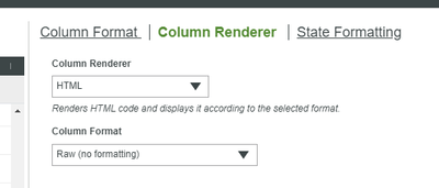

I'm trying to display an image in a cell with the grid advance widget in ThingWorx 9.1.8.  I have a data table returning an HTML string for the image and the column set to HTML, but nothing is displayed.  I've verified the image name/source is correct.  I tried following this code...

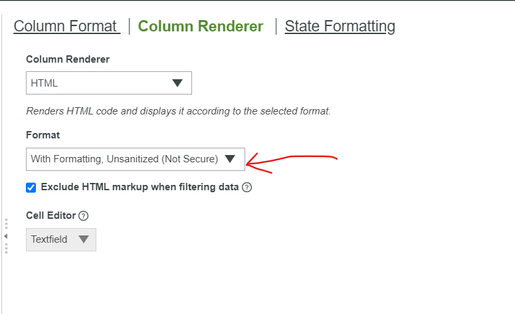

@EK_10370207 , check whether appropriate runtime permissions are assigned to this media entity. Also, Column format should be 'With Formatting, Unsanitized (Not Secured)'

Hi @EK_10370207 ,
I am also using this feature at many places in our applications.
In the screen capture you shared, I noticed your forming url starting with in "/Thingworx/.......". However you will need to form the absolute URL like "http://Host:port/Thingworx/.......".

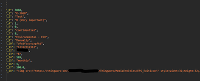

@ShirishMorkhade ,  thank you for the suggestion, but it still does not work for me.  Below is a screenshot of the infotable results.  It returns the full url, and resolves to a valid destination, but I don't see anything in the grid.
