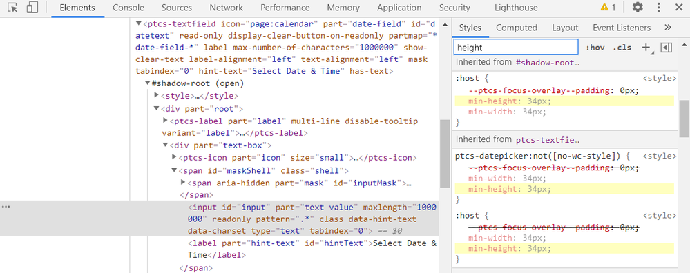

Hi @mervinnobelraj ,
The height doesn't change below 34px in the Properties panel, I have tried that several times.
This seems to be the min height. I was looking as well in Developer Tools and it does seem so.
Hi @Ciprian-Traian ,
You can configure the style properties for height - 25px and use the custom css given below ,
and i have highlighted in the image in that part="text-box" you can inspect it and write min-height:25px.
ptcs-datepicker::part(date-field) {
min-height:25px !important;
