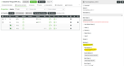

Regarding #4: RunningStatus_MCC property is BOOLEAN and Remote Property. Is possible to update the remote property from subscription or service without binding with kepware tag?

Yes, I correctly configured the asset status property.
In composer, I removed the tag binding. But, not able edit the "Binding" and it's still remote property. So unable to update the from the service.
I'll admit I suggested this without trying it first. I'll try to do this soon, but it could take some days before I have time. If you manage to do it, please let us know how you did it.

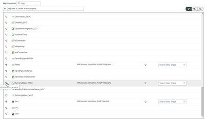

For removing the tag, have you tried to use the "Manage Bindings" button over the list of properties, and in the popup, go to RunningStatus_MCC and click on the "Clear" button to the left?
Yes, I tried as you suggested.
  • Cleared  the bindings using "manage binding" popup window
  • Written a service to update the RunningStatus_MCC property
I got a below error,
Error in: Test Asset.test javascript service. Message ::Error sending a write request for property [RunningStatus_MCC] of Thing [Test Asset]

- In the Equipment configuration screen, create an attribute that will receive the status tag, for example let's call it RawStatus. Then in the Asset Card configuration screen, select it as the status.
- In Kepware, create a "manual tag", a tag with a "fake address", for example let's call it DummyTag. This tag must have Type=Boolean and be Read-Write. To create a tag with a boolean fake address, in the Address field write B0050, or if this number is already used by another tag then increase the number until you find one that's unused (for example B0052). Each equipment will require its own tag, so if you have 10 machines you will need 10 tags..
- Go in Composer, on the equipment's Thing. In the properties screen, use the Manage Bindings button. In the left panel select the manual tag (DummyTag). and drag to the right panel on RunningStatus_MCC.
- Create a subscription. For the input, select Event=Datachange and select the attribute (RawStatus). In the code, write this :
if(events["Me_DataChange_RawStatus"].eventData.newValue.value == "ON")
    me.RunningStatus_MCC = true;
if(events["Me_DataChange_RawStatus"].eventData.newValue.value == "OFF")
    me.RunningStatus_MCC = false;
- In the code, change the name of the attribute if needed (in my code it's called RawStatus). And also, you can change the conditions for true & false, in my code example I'm expecting that my raw status will be "ON" or "OFF", you can change those words, they are the words that your RawStatus tag will send you.
I was able to make it work like this. Let me know how it goes for you.
