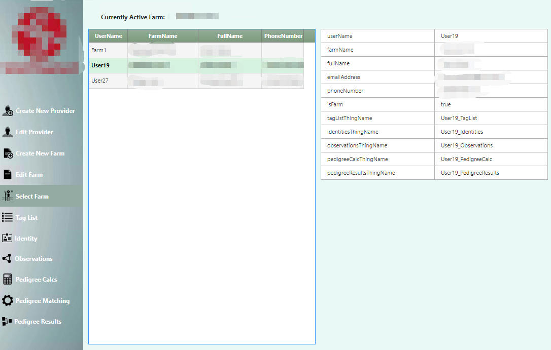

Managers can select to look at User data by selecting the user from a grid on the Select User Mashup. When a Manager does this, they will have a user property updated (that sets a Thing Name), so they can look at the data in the same way the user would.
This is working well, except once a list widget is populated on the Display User Data Mashup, it does not get updated when I switch users. If I hit refresh on the browser the list widget content is updated to the appropriate user data.
Is there anything I can do to invalidate the cache, so the correct data is displayed in the list widget?

Thanks for the suggestion, I think you may have misunderstood my scenario.
It is the list widget (as a dropdown) which is not being refreshed and not the grid data. I call a dynamic service to populate this list widget, the input is a thing name "observationsThing" which is obtained from a user property. it is the content of the list widget that is being cached.

User select a farm on the Select Farm mashup, this becomes the Active Farm. The users who makes the selection has a number of their properties updated to the same thing names as the farm, you should clearly see this in the property widget.
User then selects the Identity Mashup and the drop down you see circled is updated with data relevant to the selected farm
If the use goes back and selects another farm on the Select Farm Mashup, then go to the Identity Mashup, the drop down box data is not updated with new data, not till a refresh in the browser occurs.
The Mashups are contained within a Master, and selected using the menu.
Thanks for sharing the screenshot and explaining the situation .Well,I am not pretty sure but there might be a problem with the design of mashup .Because generally there is no problem with the list cache .I can give you on workaround for now ,you can use auto refresh widget in the mashup and set the time for refresh to 1 second or something .so that at least you don't need to refresh it again to see the new values . This is not a permanent solution but at least your can work with this for now.For complete solution you can open a support case if you are entitled to Thingworx license .
