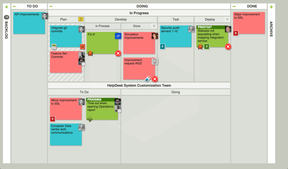

Hi.  I also would like to create a Kanban board using ThingWorx.  My customer currently utilizes a Kanban board within a product called Leankit, but would like to switch to using a ThingWorx-based Kanban board if possible, given they are already heavily invested in ThingWorx.  I have tried using Gadgets with a Dashboard mashup, but the Dashboard mashup only allows addition of Gadgets in rows - the customer needs to add Gadgets in rows and columns like they can with their current Kanban tool.  It would seem that this could be accomplished if we could add row/column layouts to a Dashboard mashup, but I've been unable to make that work.  I've submitted a Case/question with PTC, but so far they haven't been able to identify a solution.  Any ideas?
Below is a snapshot of the Kanban board my customer is using via Leankit:
https://leankit.com
Leankit.com Kanban boardLeankit.com Kanban board
Jeff
Hello @jwilliams11,
Here's how I would do that.
Depending on how configurable you want your columns to be, you can either use layouts (static, but will give you more control over the look and feel) or the Collection widget (dynamic columns, but will be pretty hard to do "nested" columns, like you have on your screenshot).
Then, once you configured your columns, within each of them you can use Collection widget (this time overflowing vertically) to display the cards. You'll also need to create a simple contained mashup for the card, of course.
After tweaking the styles this approach should be enough to reproduce the UI you are referring to, however it won't support drag-and-drop, so for changing state of your cards you'll need to use some workaround, e.g. add a couple of small buttons to each card, or a popup menu of some sort.

Constantine,
That is an excellent suggestion, thank you!  As you mentioned, all I'll sacrifice with your approach is the drag and drop capability, which isn't nearly as important as the layout and a few other features.  In fact, I think using the collection widget will lend itself better to displaying dynamic cards than using the Dashboard/Gadget approach I was originally pursuing.

Thank you for your response and suggestion, but what you suggest won't provide the Kanban board capability we need to provide.  Please see the attached "LeanKit Kanban Example" for an idea of what we're looking for.
We're moving forward with Constantine's suggested approach, though we still need to provide drag and drop capability of the project cards on the Kanban dashboard if we can, which we're still trying to figure out in ThingWorx.
