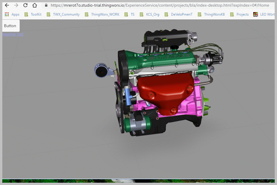

This is option is applicable on windows plattform where the vuforia studio is installed. It used the preview mode. The option is described in PTC article:
It that possible to embed ThingWorx view app main function into a webpage
So the effect is the following - see picture above so  that it could be called  form a link in a Thingworx mashup (unfortunately this will not work inside a Web Frame widget) and it calls the preview from the Experience Service.
This also will display the live data! Here below an other example:

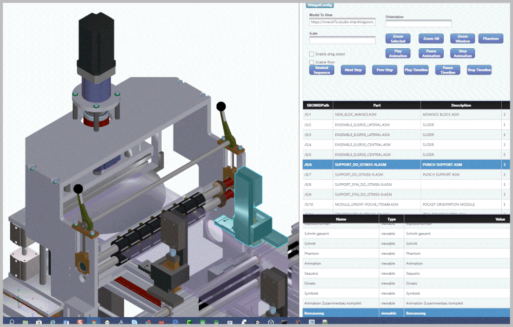

What you can do in the thingview extension:
  • you  can display a model (preferred  *.pvz format) but also other formats e.g. glTF could be used (but not 100%support -> e.g  for glTF format some models with large data size will be not displayed)

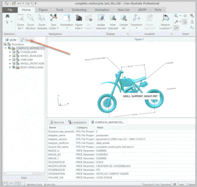

  • you can display viewable - means illustrations -  in Creo Illustrate corresponds to the  Figure:
  • Zoom, pan Zoom All, Zoom Window, Zoom selected instance, set Phantom display
  • Play, Pause,Rewind, Next, Prev Step -> allows to play a sequence steps
  • Play /Stop/ Pause-Timeline are intended for playing of Timeline animation. This means that the sequence  contains an animations:

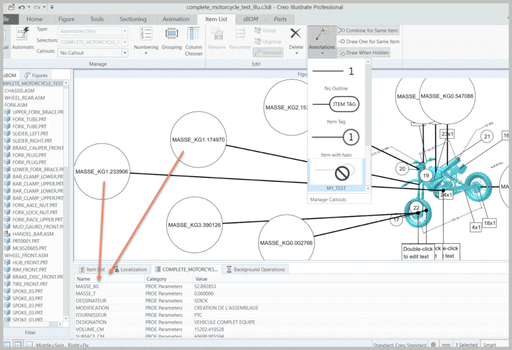

2019-01-17_18-20-33.gifDescribing what is possible in this extension will indirectly answer your question. But to make it more clear - it is currently  not possible to change any visible values in the 3d Model display

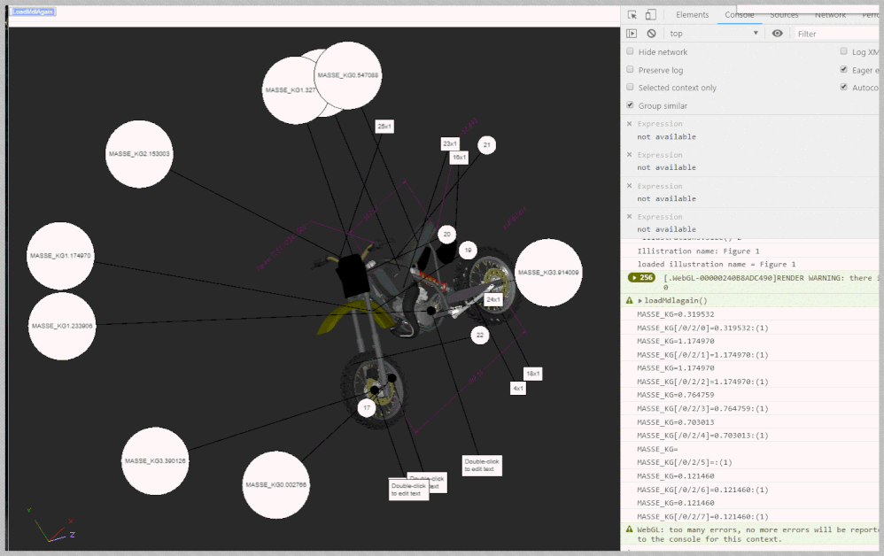

To be sure I tested also with the API in Creo View WebGL api where we have more possibilities. For example in the picture below:
we have here a callout symbol which used a Creo parameter. So that the parameters / attributes of the components will be displayed in a particular figure. The idea was to change the parameter and so to change the display.  The API could change the parameter fine but unfortunately the display will not update!
2019-01-17_17-15-57.gifSo means that the parameter change will not be displayed in the view and we cannot use a parameter to display any dynamic values.
  • One possible option which you can check  --> In case that you have a value which could be represented by enumerated scope [1,2,3,4,5,6,7 ] - in this case you could define for each different value state a firgure which could be displayed so it could be change the  static callout Display.  I think this option will work only in few cases
  • What I think will be better  to display your model with callouts where the different measserments are marked with callout number and then to have a table with the lived date which maps the number/tag from the 3d model to the lived data measurement.
