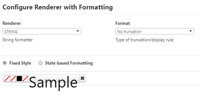

          In the list widget properties, ListFormat will be there. By giving custom style and adjust text size in that you can make it visible.

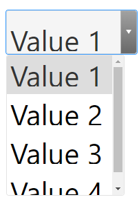

The list with 42 as text size is viewed in UI as given below
