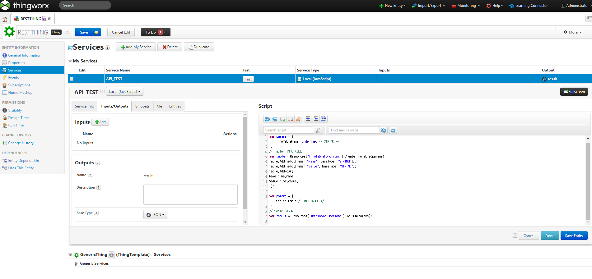

I make service
and execute service with api
but result is Invalid Request..
what's wrong?

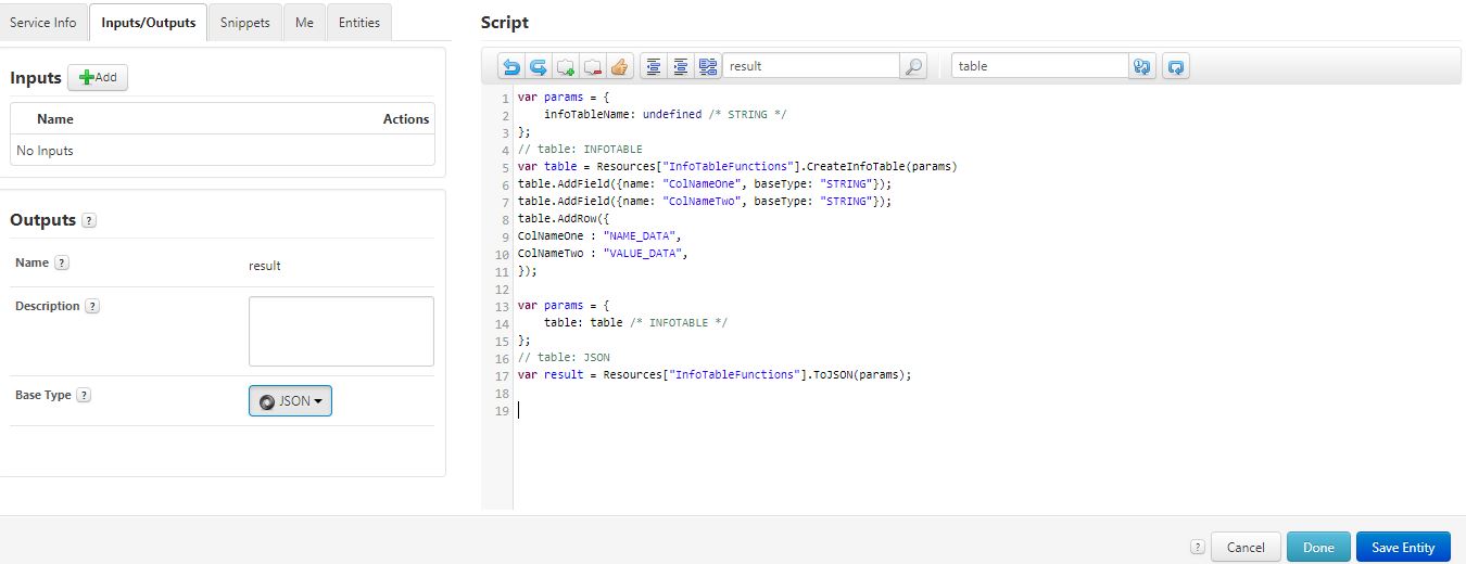

Output Base Type?
Output base type is JSON
Try to use,
var params = {
	infoTableName: undefined /* STRING */
// table: INFOTABLE
var table = Resources["InfoTableFunctions"].CreateInfoTable(params)
table.AddField({name: "ColNameOne", baseType: "STRING"});
table.AddField({name: "ColNameTwo", baseType: "STRING"});
table.AddRow({
ColNameOne : "NAME_DATA",
ColNameTwo : "VALUE_DATA",
var params = {
	table: table /* INFOTABLE */
// table: JSON
var result = Resources["InfoTableFunctions"].ToJSON(params);
Thanks.

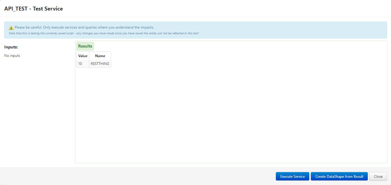

now result is showing like pictures

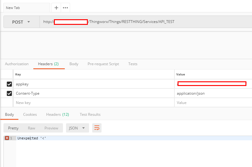

and i test API following URL
but REST API return invalid request
request API URL isn't wrong?
It returns the ThingWorx service definition instead of JSON when attempting with the following URL:
Can not get value in the following general JSON form?
         "name": ThingName,
         "value": PropertyValue
Please test with Postman.
Postman test results.
I'm hopeless ...
Why does not it print in JSON format?
