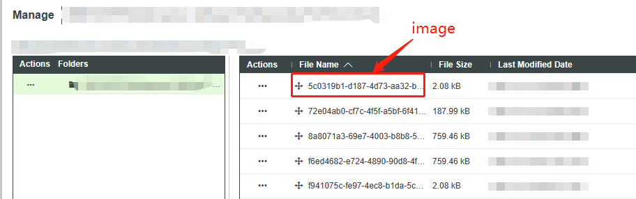

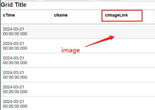

Hello,everyone!
Why does it fail when I use the AddDataTableEntry service to add an image from a repository to a table?

It worked for me.
Rocko
March 21, 2024
Hard to tell with the information given. Check the logs. Maybe the user lacks access/service execute privileges to access the file.
Maybe it does not get added to the DataTable. Maybe it's not queried correctly. Maybe the type is wrong.
Check if the link is contained in the datatable. Check the link is contained in the infotable you use as data source in the grid.

hi @Snoopy_hu ,
In Column format of the colum "cImageLink" what did you give it?, it should ImageLink type

Yes, I chose the imagelink type.
