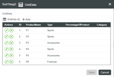

Rayon_11
(To:Arun_C)
This is the Input data which I have created in Thing  using Infotable property.
Input Data:
In the same Thing I created   service which you shared but still not working
Best Regards
Rayon.

Rayon_11
(To:Arun_C)
Hi Arun,
Now I am getting the result, but the percentage column is not working.
and  GridData is a Thing InfoTable Property
I used just the above code now getting the output but Percentage coulumn is blank
Best Regards,
Rayon.
Hi @Rayon_11 ,
Have you checked all the ColumnNames are correct based on your datashape fields? Also please verify this 'PercentageOfProduct' is correct and its baseType 'STRING'.
InputData.rows[i].PercentageOfProduct = calculatedPercentage + '%';
If its not sloving your problem please share you Datashape in xml for further investigation.
Thanks & Regards,
Arun C
Rayon_11
(To:Arun_C)
Yes I have checked the column Name initially column PercentageOfProduct base type was number but now after changing it to string type still getting the same result and also other column has  base type like
ID-> Number
Type-> String
ProductName -> String
PercentageOfProduct -> String (Changed)
Category -String
 But still geting the same result.
Rayon
