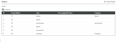

Now I am getting the result, but the percentage column is not working.
and  GridData is a Thing InfoTable Property
I used just the above code now getting the output but Percentage coulumn is blank

Hi @Rayon_11 ,
Have you checked all the ColumnNames are correct based on your datashape fields? Also please verify this 'PercentageOfProduct' is correct and its baseType 'STRING'.
InputData.rows[i].PercentageOfProduct = calculatedPercentage + '%';

Yes I have checked the column Name initially column PercentageOfProduct base type was number but now after changing it to string type still getting the same result and also other column has  base type like
ID-> Number
Type-> String
ProductName -> String
PercentageOfProduct -> String (Changed)
Category -String
 But still geting the same result.

Hi @Rayon_11 ,
I have tried multiple cases its working fine in my environment. Can you please share your Thing Entity and Datashape Entity for more investigation?
