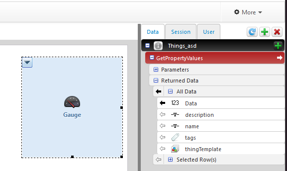

I have progress gauge widget on mashup and I have one service which fetching the data from database, how to show fetched data into gauge widget? What I have done so far, bind service data to the progress widget, bind mashup loaded trigger to the service, still I am not able to see data in a widget, as I am very new to this platform please help me to get out of it.Thanks in advance.

Can you specify what type of data is returned from your service? If it is infotable just pick numeric value which is intresting for you like this:
Bind it to the Data property and that's it.

Thanks Adam. Previously I haven't added Data Shape for that service, now it's working.
