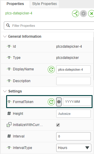

Hi Preeti,
May I know the version of ThingWorx you are on? Starting from version 8.5, Date time picker widget lets you format the date OOTB. Use the new DateTime picker widget and set the FormatToken property of the widget to your desired format. Please refer to the attached screenshot.
If you are on the older versions of 8.4.x, please refer to the beta widgets section and find the "Date Time picker" widget and see if you have this option.
Best regards,
Thanks Rajesh. It works for initial display. However the requirement is to only select month and year. This BETA widget still allows them to pick a date. So its confusing. Our metric date range is beginning to end of the month.
Is there any other workaround?
