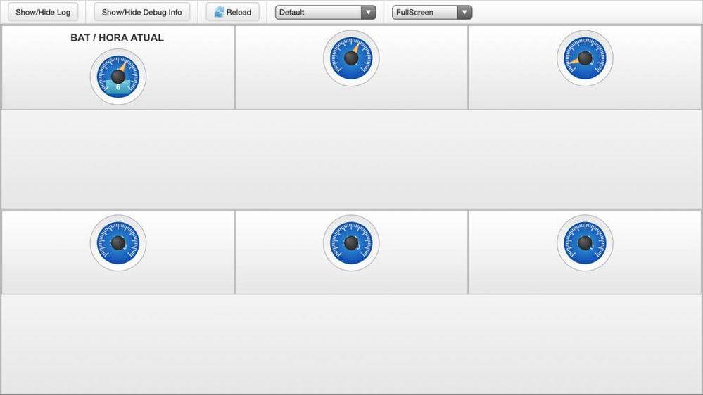

I did the following:
I have created a mashup (type: responsive advanced), but when I run the mashup in smartphones IOS the screen not to adjust automatic and when I run in smartphones Android the screen it is ok.
Have you ever been through for this problem?
Follow below the images:
AndroidAndroidIOSIOS
Hello again leinsfeld,
I have not seen this behavior personally.
As it looks like it may be a defect please open a case with PTC Technical Support via the PTC Support Portal and we will proceed to open a defect with R&D if applicable.
