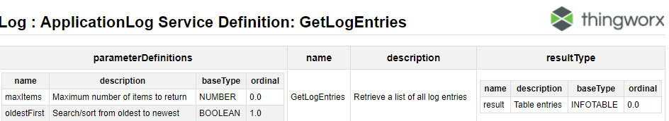

You can query the Logs entity, <ThingWorxServerName:portNumber>/Thingworx/Logs, e.g. there is default function like :
http://localhost:8080/Thingworx/Logs/ApplicationLog/ServiceDefinitions/GetLogEntries
or
http://localhost:8080/Thingworx/Logs/ApplicationLog/ServiceDefinitions/QueryLogEntries
or

This link returning definition of the service, but when try below link it returning application log
http://localhost/Thingworx/Logs/ApplicationLog/Services/QueryLogEntries
