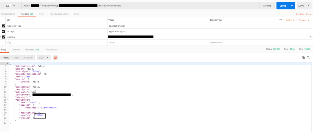

I created custom service to fetch InfoTable data through Rest API and tried converting the output of the INFOTABLE using INFOTABLE.toJSON() function and set the output parameter accordingly but while I am trying to access it using rest API I am not getting the output in the JSON format.829D10B7.PNG

Hello @PaiChug, I tried attaching the data shape and then using stringfy() method on it however the result which I am getting is of the form whose image is attached below where it says BaseType = String and could not get the data which is stored in the infotable.I tried executing the service using REST API from Browser as well as Postman.

In Thingworx,when I executed service I get result in table format ("JSON / String / Infotable") with header as per datashape but when I called same service through RestAPI method or Postman then result will be in single word "JSON / String / Infotable" as per service output.I want result in form of table like Thingworx. I attached Postman service for your reference.
The problem which I am facing is I am unable to view the contents of the INFOTABLE even after I set the accept and content type parameters along in the postman.
