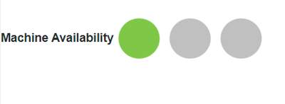

I have to show three results in the mashup as shown in the below image,
and I have some conditions such as,

based on this conditions result i need to get the checkbox switching  , if current is greater than 3 then machine available should be true, if current is less than 3 and greater than 2 then partially available should be true, and if current is less than 2 it should show machine is not available ,
How can we achieve this, and also if machine is available it should show with green , if machine is partially available it should show with orange , if machine is not available it should show red.

My suggestion would be instead of showing 3 checkboxes for the machine status, you can put shape and change color based on availability
If you want to show them separately I have also included them in the sample code
Note: I have used shapes instead of checkboxes

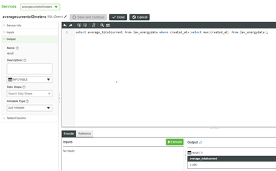

Instead of giving input , I have the averagecurrent data from the database which I am retrieving by writing the query as shown below,
 it is getting me the latest row data , and output is infotable datatype , but I am not storing it in a datashape as you can see in the above image , this sql query service output should be taken as an input and based on the conditions it should give the machine availability result, so when i try to write a javascript code and click on the service averagecurrentof2meters, automatically the result variable will be assigned to the service and the result variable for the boolean type will be getting error ,
How to solve it and make the sql service as the input ?

You can simply get value from InfoTable like this :
// value from SQL Query
var sqlOuputInfoTable = <<SERVICENAME>>
var averageValue = sqlOuputInfoTable.average_totalcurrent
// To get infotable value based on index
// var averageValue = sqlOuputInfoTable.rows[<<ROWNUMBER>>].average_totalcurrent
