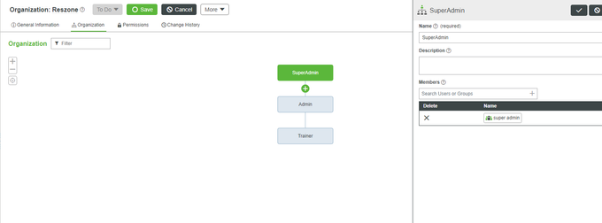

I have one organization name as "rezone" which under there are sub-organization which shows I below imageUntitled.png
Each organization unit include it group which contained many users,
SuperAdmin - super admin group
Admin - admin group
Trainer- trainer
I want to give visibly permission to each group so that whenever I am login with any user it will show his related mashup after login.
EX. If I log in with super admin user I want to show the super admin dashboard mashup after login
same when admin login I want to show the admin dashboard mashup and,
when trainer login I want to show the trainer dashboard mashup.

In the General Information tab you must select a Home mashup to which all users will be forwarded after the successful login.
Inside that mashup you must use a ContainedMashup widget whose Mashup property will be fed by a service that you must create in ThingWorx. That custom service should return the Mashup name you want based on the currently logged in user belonging to an Usergroup or Org - however you want. You will need to keep that mapping somewhere - a DataTable sounds enough for this (UserGroup -> MashupName)

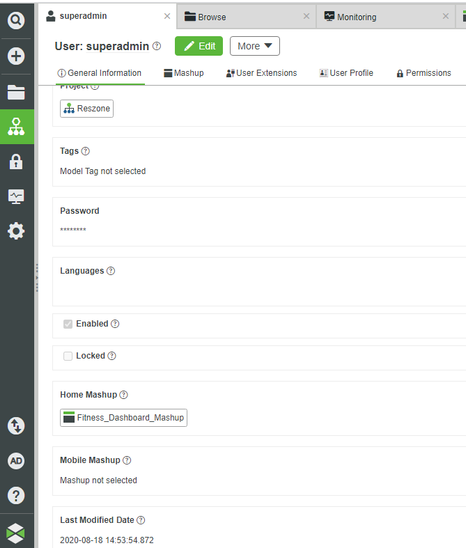

Hello @Suraj2692,
You can verify the mashup was assigned to the user by finding that user entity and checking the Home Mashup specified for the user. If the Home Mashup was assigned correctly and you still cannot see it upon logging in, then the issue might be related to permissions. Ensure the User/User Group has permission to view the mashup and all its containing entities (Things, Thing Templates, Thing Shapes, Data Tables...).

Exactly, That's my question on how to give visibility permission to the non-admin users when they log in, it will show there related home mashup which I already assign to the user while creating on mashup.
You can see the above image, super admin assign a home mashup still it will not showing home mashup after login.

I gave home mashup visibility permission to the super admin group from the permission tab in the mashup, but when I log in it will show me home mashup but not all data on this home mashup.
Am I wrong somewhere? Can I have to give all things,thingshpe,datatable mashup etc which comes into the super admin picture?
Is there any quick way to give super admin all entity visibility permission?
emscur
(To:Suraj2692)
Hi @Suraj2692,
You need to give all the required permissions for the user to perform actions in this mashup. For instance, user needs run time permission to access and execute the services in all entities included in the mashup, such as service execute privileges on all services called by mashup, for example.
