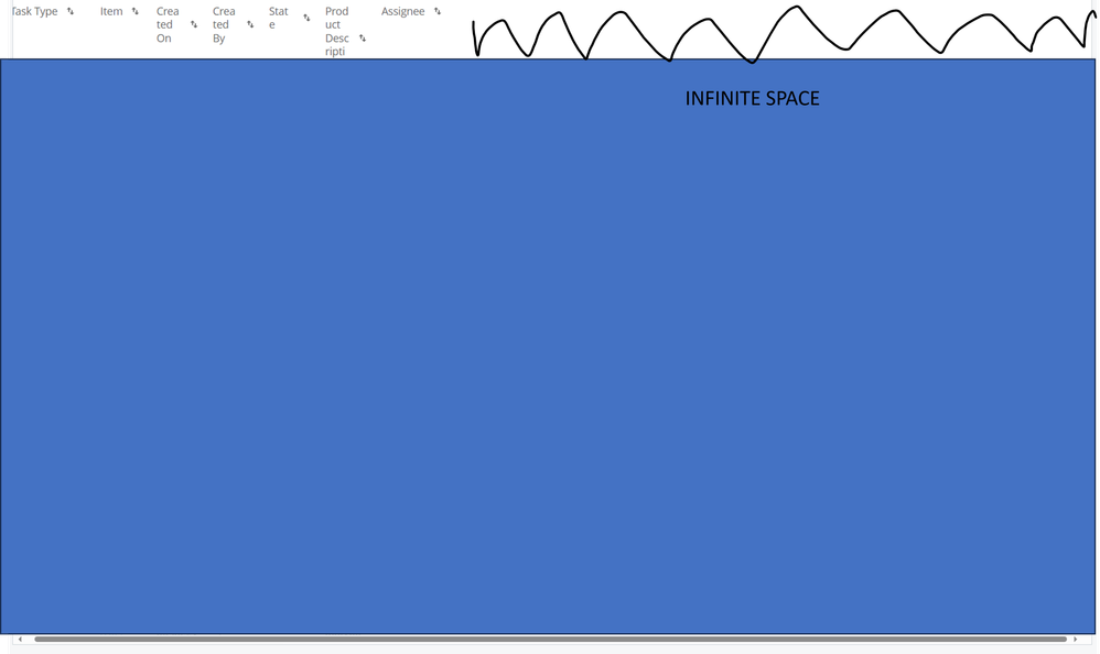

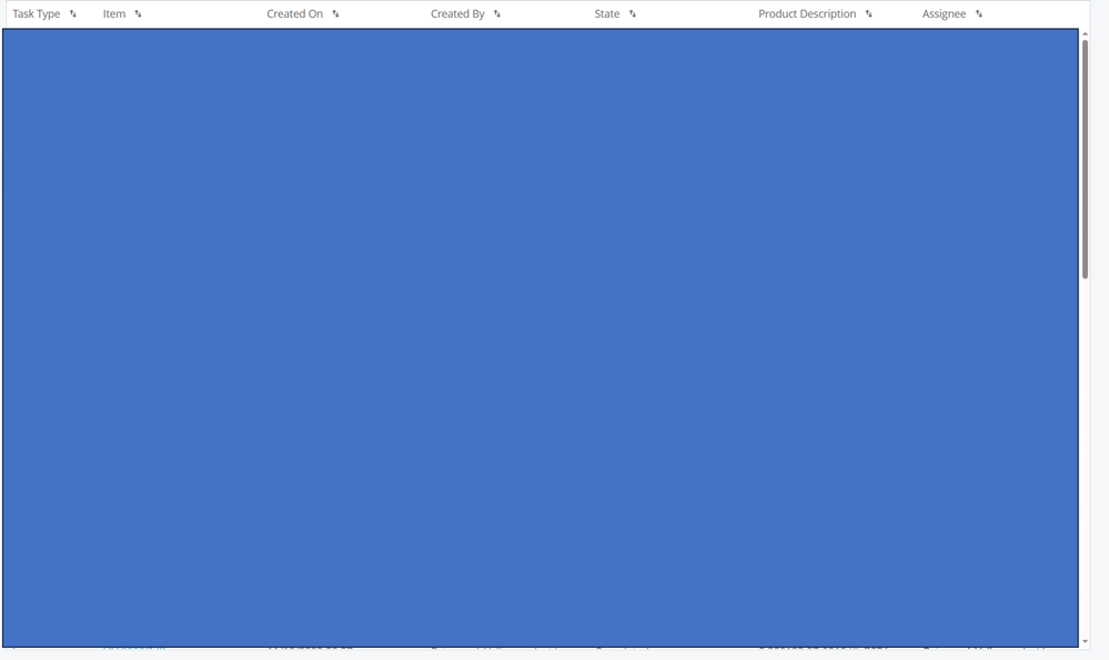

Hi @abandal
The problem is scroll bar doesn't disappear once we resize the column in Runtime.
When the grid gets loaded this is how it looks (without scroll bar)
After resizing any one column, the horizontal scroll bar never disappears even after making all columns to minimum width in runtime.
