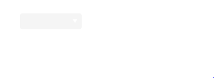

Hi @CHASEONHO,
There was an issue the previous versions that blank tooltip shows on mashup even if there is value selected in dropdown. This is fixed in ThingWorx 8.0 version.
The current functionality is tooltip will be visible if there is some value selected in dropdown list and tooltip will not be visible if there is no value/blank in dropdown list.
Tooltip visible when value is selected
Tooltip not visible when no value/blank in dropdown list.
Tooltip will be visible only when we hover the mouse over dropdown.
Himanshu
