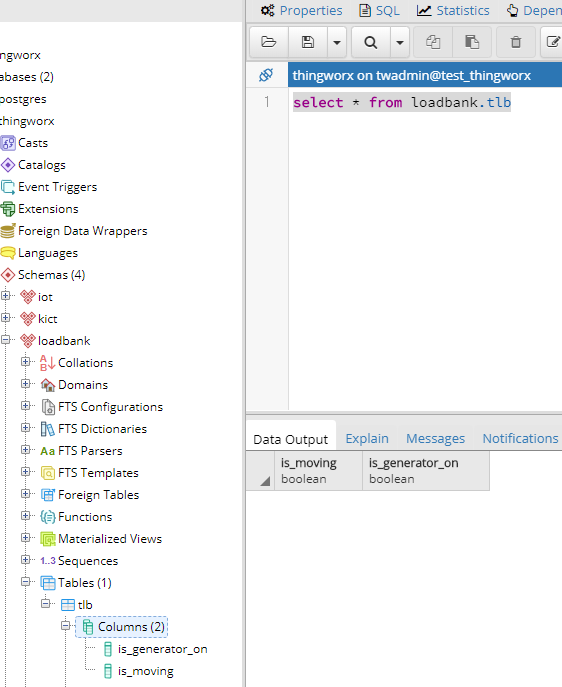

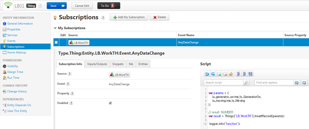

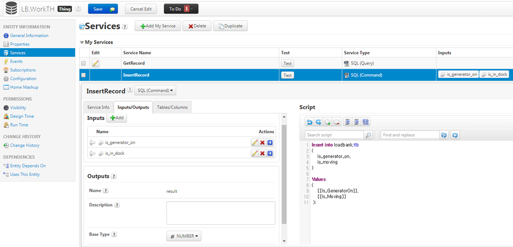

Can anyone help me in regard to this subject with posted capture i attached ?
It would be appreciate if i get a reply from you.

Does this work if you hardcode the values that you are inserting
to be true/false or 0/1 ?
probably make that work first before going to the input parameters.

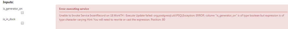

jsok
(To:PaiChung)
hello  PaiChung
It works as attached photo when i clicked Input action but i don't know why.
You pointed the hardcord value are just type by myself ?
If so then how did you know ?

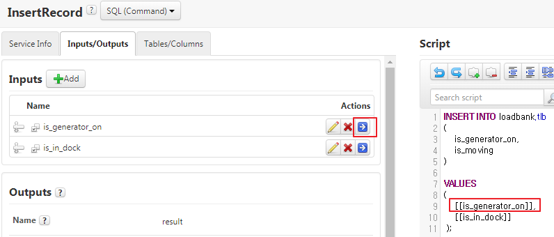

PaiChung
22-Sapphire I
(To:jsok)
Not too sure, seems like it is at least picking up one value.
are you sure both input parameters have values assigned?
you could try to replace [[is_in_dock]] with just TRUE or FALSE (or 1 / 0)
and see what happens, this at least will confirm a value is written
if that is the case, then most likely you are not providing is_in_dock when the code runs
can it have to do with mapping?
