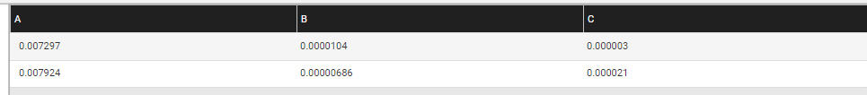

I did a quick test and here is the result:
CSV file:
A B C
0.007297 1.04E-05 3.00E-06
0.007924 6.86E-06 2.10E-05
Result in AdvancedGrid widget:
Same code as in this post has been used to load the csv.
