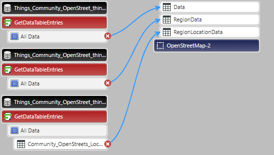

Need a help regarding how to make a geofence on openstreet map .I had tried the steps that had been mentioned for Google map widgets and Baidu but the same doesn't work on openstreet map .Please help me regarding this .

The next step is to bind the data to the OpenStreets Widget. There are 5 different places to bind the data.
I used "Data", "RegionData", and "RegionLocationData".
If you want to see a pin in the map where you location is Drag the ALL DATA to the OpenStreets "Data" binding.  Having done that you need to select the field which will be used for data. This should look like:
Also make sure that display is turned on:
You should see one pin.
To see a region takes a few more steps:
Drag ALL DATA to “RegonData”
Drag the info table from inside your ALL DATA to the “RegionLocationData”
You should now have something that looks like:
Now you need to configure the region information, similar to what you did for the location.
The choices I have may be different from yours. But you should have a choice for each field.
Then make sure that you have turned display on, "ShowRegions" needs to be checked.
Save everything and view your mashup. You should have something displayed.
