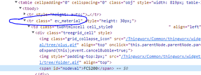

You can use this css:
.<myrowclass>:hover {
    cursor: pointer !important;
where <myrowclass> is the name of the class on your tree rows... for instance, on one of the PTC tree grid examples, the class name is found here:
Hope that helps,
Nick
