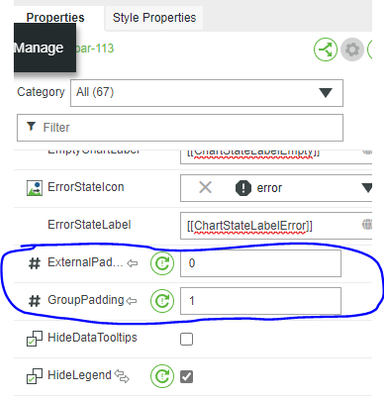

I want to reduce the spaces between two lines of bar chart and also want reduce their width how can I do that
as you can see the image I want there width should be minimum and also gap between these two as well
Hi @LY_10691079 <
Try the below Padding in the Style Properties; for me, it worked.

Hi @LY_10691079  Look at the below reference link, and let me know if it will work in your case or not.
https://community.ptc.com/t5/ThingWorx-Developers/Remove-Extra-Spaces-and-Rest-Layer-in-Line-Chart/m-p/938622#M66055
Hi @Surya_Tiwari  I didn't get much from there can you pls explain it
Hi @LY_10691079 <
