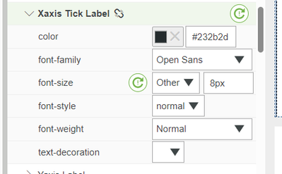

For Line Chart, you can try changing XAxisType to Date/Time and set XAxisDateFormatToken. Also, set HorizontalAxisLabelsRotation to 0.
In Widget Style Properties, reduce Xaxis Tick Label font size  to fit into the chart
For sequence, you can set NumberOfSeries to 7. Select DataField based on your sequence
