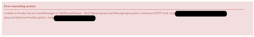

Hey there,
why I can not connect my ThingWorx Composer to an internal SMTP server? I can connect it with telnet.
