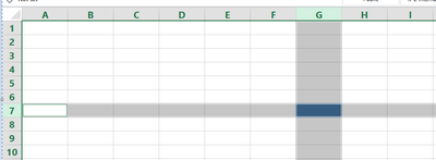

-I want to apply cell color in advance grid widget, like intersected cell between row and column selection.
-When I will select row and column in advance grid widget then intersected cell should be highlighted with background color.
I have implemented though mashup CSS, its working but not consistant,solution. "cell_style5" is not constant for entire application. Its keep on changing like cell_style4,cell_style5,cell_style6
.rowselected .cell_style5{
background-color:#00cc66 !important;
border-color:yellow !important;
border-block-width:revert;

- I am using Thingworx Version 8.5
- Basically, I have made configuration service and binded to 'Configuration' properties of grid advanced widget.in this service, I am using 'rowselectedstyle' & 'selectedcolumnstyle'and in runtime.I am able toselect column and row selection.
- So between column and row selection, there is one cell is intersecting....that cell to be highlighed with border or background color.
-This is my exact requirement.
I have implemented css in mashup as explained above but that 'cell_style5' which is observed in developer tools is not consistently working ,if i am navigating mashup to mashup
-Please suggest any solution on this
