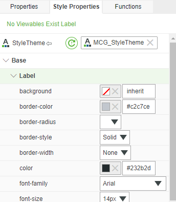

I struggled with this for a while, trying to use CSS to change foreground and background colors in containers and widgets.  In addition to the other good comments here, check the label's color in the style.  For example, my label has a color of #232b2d (which comes from my StyleTheme).

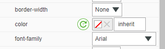

In this case, adding a custom class that sets the color will do nothing.  To use a color defined by a CSS class, change the label's color to "inherit" by clicking the "X" next to the colored box.
Now the label should display the color specified in the custom class.  The same thing applies for container backgrounds, etc.
