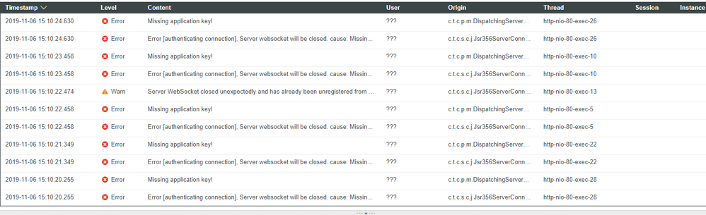

I installed ThingWorx 8.5 but in Application Log I am getting the below errors
jaswanth
i am getting these errors with a consistency of 1 sec and in between I am getting that stack is growing Large I just installed 8.5 new version didnot create anything  application keys or any sort of connectivity just installed it fresh and these were the errors.Can any one help me with this issue?

I am guessing that either you had a Kepware, an Edge SDK implementation or some Mashup with GetProperty Values that was connected to a previous ThingWorx version.
Was this a clean install, or did you upgrade?
This was a clean install.yeah we have previous instance connected to kepware but we disabled all kepware connections in kepserverEX.Can you specify why this  error is present like I dont have any appkeys and industrial connections in the 8.5 as it is new and how to solve these errors? I was able to connect to kepserverEX with new appkey and Industrial Connection but these errors are still present
I can only advise on what I would do, since I did not encounter this situation.
I would try to go in Tomcat's log folder, then look at the latest access_log file to detect at least from which IP those requests come (an example in my machine is this localhost_access_log.2019-10-03.txt).
You might find out this information in the CommunicationLog.
Another way to understand where that connection comes from is by using netstat or TCP view, to see the actual TCP connection that arrives in your ThingWorx Tomcat port.
I still believe it's a process that was not killed. Try to hard kill the the Kepware process, make sure you did not have the Academic simulator open.
I hope these pointers help.
Thanks VladimirRosu for insights but the communication log is empty and the tomcat catalina logs is just having 20 lines with time of 8.5 installation and info that it is deployed succesfully.I don't have idea about about netstat and tcp view i will look into it

jaswanth
(To:slangley)
hi @slangley No I was not able to resolve the issue,My friend also installed 8.5 even for him the same issue is present we haven't figured the solution yet

jaswanth
(To:slangley)
Hi Slangley,
we connected our ThingWorx to Kepware OPC data and send tags information to thingworx(using Simulator driver)
and the errors were gone. I am not sure if this is what stopped errors even after disconnecting kepware I don't see errors so I hope this is the solution.I am marking this as Solution if anyone have other queries regarding this please post it here.
