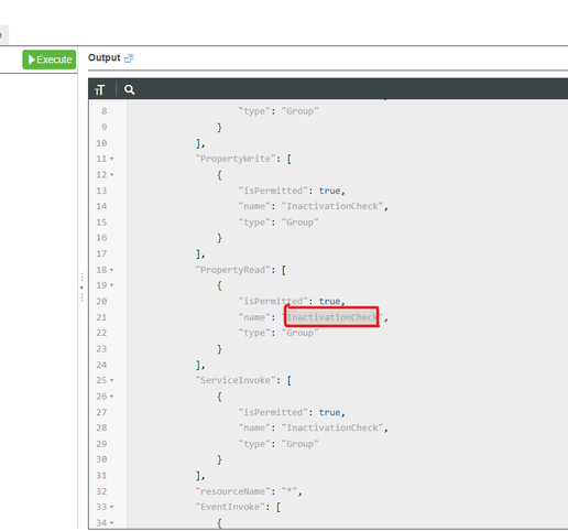

I am trying to get the Permission of a Thing in JS Code, when you services like GetRunTimePermissionsAsJSON  or GetRunTimePermissions I get the InactivationCheck in the output of the Service.

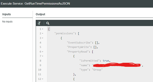

If I Run the Service from the Thing, by opening and executing it, I can see the data properly.
Shashi Preetham
1 ACCEPTED SOLUTION
I made a workaround as of now.
  1. Created a service in each thing, which sets GetRunTimePermissionsAsJSON or GetRunTimePermissions data to a dummy property.
  2. Later, I created a Helper Thing, where I made a service that calls/Fetchs all the property data from the Things we set in Step1.
This modified workaround gives me all the Things permissions data.

And you made sure there is no group (accidentally) called "InactivationCheck"?
Please also always include which TWX version you are running. (It did work for me on a 9.3.10)
Hi @Rocko ,
Thanks for quick response, and apologies I missed Thingworx version, as of now Thingworx Version is 9.2.6.
and yes, there is no user group with "InactivationCheck".

I don't have a 9.2 around to test, but I've never seen this before. You could try running this with a different user. If it persists, create a ticket with support.
