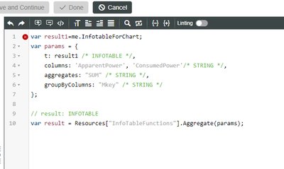

Hi ,
I am trying aggregating multiple columns as shown below, i tried with putting comma separated columns but don't work. What is the solution?
when i try with only one column, the above code works fine.

You aren't using the right format, columns it's a comma separated list of values, and aggregates also:
var result = Resources["InfotableFunctions"].Aggregate({
t: result1,
columns: "ApparentPower,ConsumePower",
aggregates: "SUM,SUM",
groupByColumns: "Mkey"
