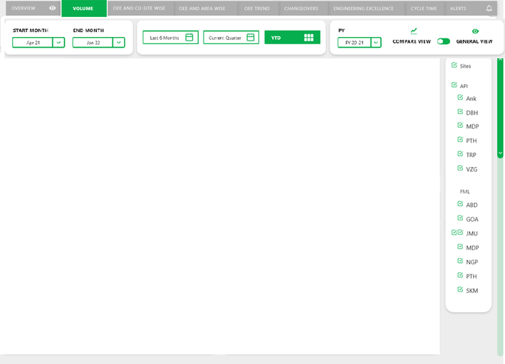

Hi Developers,
Im working on a mashup as shown below. I have this input container with the start and end month dropdowns and other input widgets. I want to use the same containers across all the tabs.
I've tried to use a mashup container to reduce the redundancy of binding the input widgets across the tabs. Im using session variables to pass the information to the Parent mashup. The problem is that the selections made on one screen are not visible on other screens which messes up the selections made in the active tab.
How to overcome this? Is there a better approach for this.
If there is a direct connection between the Parent and Child, you could just use Mashup parameters, bound two ways, that should propagate updates.
If the session isn't reflecting, then you will need to use some event to use GetGlobalSessionParameters and update the fields that way.

Hi Pai,
Thanks for your reply. I have been populating the mashup name on tab load to reduce the amount of services getting loaded. So mashup parameters are not available when i bind the mashup name from a service out put. I have created input panel as a standalone mashup and then using mashup containers i can get the same across the tabs.
