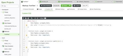

Seeing this error in the application logs: "Internal Error: /appl/thingworx/ThingWorxStorage/repository/SystemRepository/Fonts (Is a directory) ".
The folder is available in the repository and required permissions are also applied. Unsure why this error is being thrown. Any suggestions would be appreciated.

@Soura You haven't provided many details (screnshots / logs / steps to reproduce) on this so it's difficult to help you to pinpoint the cause on your side, but here is the working example of how it works (see the attached video and the screenshot below).
You can also refer to TS articles like CS322901 , CS315780 and CS332429.

@DmitryTsarev, Thanks for responding. As mentioned unsure when and what caused this error to be thrown. This error is also seen for Administrator users. No custom code involved at this point. Trying to get a font applied to a mashup text.
Thanks for responding @DmitryTsarev . As mentioned unsure how this error started and hence unable to share the details. Will keep the issue under observation and keep all posted. As for fonts, I am already applying the fonts correctly. Thanks for the links.
