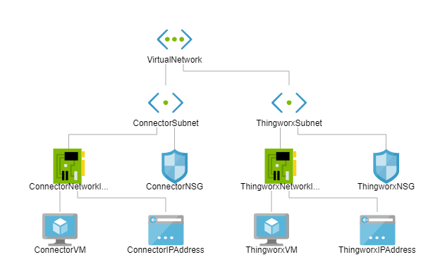

Here is my communication arquitecture:
All is in the Azure Cloude, in the same Region and I can psping and ping my two Virtual Machines without any problem. Using their ip public address and their private address.
I tried tried to change the eventHubNamespace like you said but now i have this errors:
The ConnectorVM on the ConnectorSubnet must be able to connect with the ThingWorx IP addresses on the ThingWorxSubnet.

Hello again, I already check that my ConnectorVM and ThingworxVm can communicate with each other.
On the other hand, I followed what you said and created all over again my IoT Hub, all with lower case letters. And I'm getting the same error trying to connect.
I can import the device I have in the IoT Hub, but I can't see data comming to my Thingworx platform.
