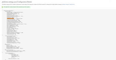

I would like to clear that this is just for one of our customer who wants the pictures to be stored automatically when he sends the request with picture to thingworx and not globally needed feature. Its just for one customer (customer is internal so there is no security issue in organization) and he does not want to do it manually from phython script and this is why i would like to do in thingworx.
also about saving picture in fileshare there are several folders and that i need to choose in the fileshare link that in which folder i need to place the picture and that parameter i would also get from front end that in which folder this picture belongs
Now about third point which you have mentioned that it is the best way to achieve this task, i would start from it. as you can see screenshot below also for the platform-settings.json so in this fileRepositoryRoot now should i write it as object for eg
"FileRepositoryRoot": {
"claimsRepo": "\\\\aema.universe-world.com\\test\\USER\\...\\claim"
 but it can create an issue if i remove /ThingworxStorage
Yeah, that would apply to all repos in the system. If you only want to do this for one of them, you should probably go the symlink route.
