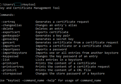

Check if you can run keytool from any cmd , I saw some error regarding the keystore.

 i can't find the folder local-mode-cache in thingworx folder and  i can't find any file or folder name "keytool".

This is working for you? Just type keytool in cmd
Yes, this command is working.
