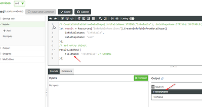

I only found out that it seems to use the friendly name in composer-result view:
DataShape with a property "FieldName" and a friendlyname set:
Service output result shows "Friendlyname" as header:

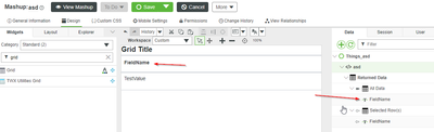

Mashup only shows "FieldName"
Not sure of the intended use of "FriendlyName"-feature.
Edit: In the docs I only found that this widget makes use of friendlynames in runtime: https://support.ptc.com/help/thingworx/platform/r9/en/?#page/ThingWorx/Help/Mashup_Builder/Widgets/PropertyDisplayWidgetThemable.html (if you search for "friendly name" on the page you find "If the field has a friendly name defined in the Data Shape definition, this name is used.")

I think now I know what you try to do:
  1. You have a DataShape A with property e.g. 'name'. This DataShape has no friendly names set.
  2. You have created a second DataShape B with same properties e.g. 'name', but additional friendlyname set
  3. Now you created a service like
let dataShapeAInfotableWithData = // get the data from somewhere
// service return result is set to be of type DataShape B
result = dataShapeAInfotableWithData;
  • And when executing the service, in the end the result does not have the expected friendly names of DataShape B.
If that is your issue I can explain it: Defining a result datatype is not converting the result of the service into the specified return type. This is just for "developer" interest/documentation basically. The result should be of that type.  If the service returns a different type, this type is returned. In your case you still return DataShapeA, not B.
To fix your issue you would have to create a new Infotable of the correct DataShapeB and add all rows of the other infotable. E.g.
let dataShapeAInfotable = undefined; // get data from somewhere
// CreateInfoTableFromDataShape(infoTableName:STRING("InfoTable"), dataShapeName:STRING):INFOTABLE(AcceptableMissedPings)
let result = Resources["InfoTableFunctions"].CreateInfoTableFromDataShape({
    infoTableName: "InfoTable",
    dataShapeName: "DataShapeB"
dataShapeAInfotable.rows.toArray().forEach(row => {
    result.AddRow(row);
 Hope that helps!
