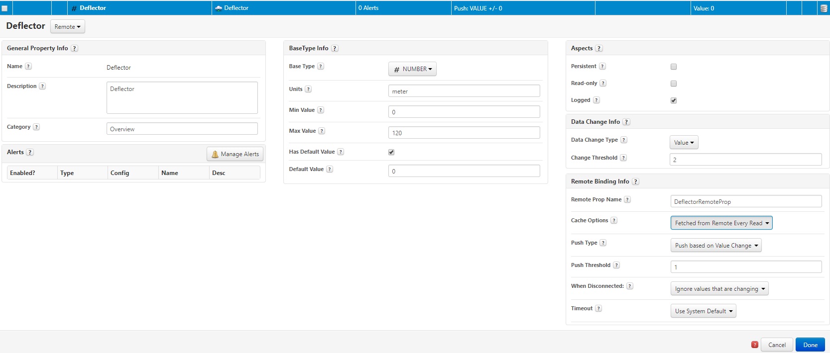

I have a template with field like "Deflector" of NUMERIC type (and other properties not show in above image).
I would like to create a JavaScript service that will based on template name return a collection of JSON objects
containing all property information that can be seen in the image.
I want to build agent with a VirtualThing implementation that will be based on this JSON configuration that can be retrieved from the TW JS service.
In addition I would like to add "custom aspects" like: System, Group and Model that can be associated with each property (Can I use some kind of linked DataTable that I need to maintain using a custom mashup where I would show property names in one column, hide ThingTemplate name (which will point to TT name) and add DataShape columns: System, Group and Model). Can this be achieved differently?

The retrieval of this configuration should come back as an InfoTable (like get PropertyDefinition or something similar or GetPropertyBinding ... )
I am not sure if you have the agent set up to use InfoTables as is, else potentially the ToJSON service can work.

This is what I came up with.
If I used GetMetadataAsJSON and GetRemotePropertyBinding I can get majority of property metadata except:
Units
Min Value
Max Value
Has Default Value
Default Value and
When Disconnected
Any way this can be retrieved somehow?
