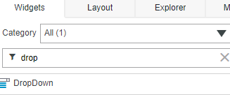

The List widget of TW8.4 is displayed as legacy List widget on TW9.x (lower one in below picture).
For TW9.x we supply a new Standard List Widget with which view property is not available (upper one in below picture).
You can keep using legacy List on TW9.x but as named this leggacy widget is planned to be deprecated in future.
Except Standard List Widget, we also supply Standard Dropdown Widget.
If you have any operations issues with standard widgets, please let us know.
