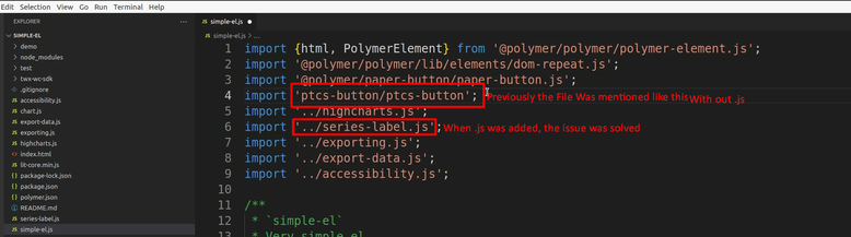

Trying to develop an Google Chart widget extension, when imported the Extension in to the TWX shows following error:

Found the solution,
Got this issue when we were using npm libraries in polymer.js. Instead of using npm libraries, we used the file.js file format

Hi @psp316r
Can you confirm you're getting the 404 error on import?  Is the same issue you reported under this post?

Hi @Rajkumar_20673
It's still not clear at what point you're receiving the error--during the import process, or after the import when you're attempting to use the extension.

@slangley ,
I replicated this issue with the attached widget and I'm getting the same errors.  The widget imports into ThingWorx just fine.  However, when you try and render the widget on a mashup, it gives those 404 errors.  After looking through the /extensions folder on the server, those libraries are indeed present but for some reason ThingWorx still returns a 404.

Found the solution,
