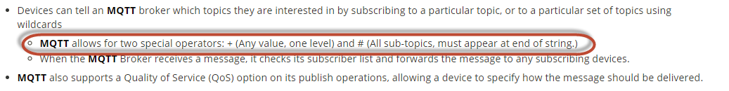

I am working with the MQTT extension and have a few questions.
Regarding subscribing to topics:
In other MQTT client and broker tools it is possible to subscribe to a topic using wildcards like '+' and '#' and in the document for support case CS246701(https://www.ptc.com/en/support/article?n=CS246701) they do discuss this functionality: MQTT subscribe info
But it does not seem to work if I add it as a mapping topic e.g. /Thingworx/+/Thing1/Property1  instead of /Thingworx/Dev/Thing1/Property1.
Is there a way to get this functionality to work in Thingworx?
I have found the following KCS Article mentioning that the feature is not available and an enhancement was reported to R&D:
https://www.ptc.com/en/support/article?n=CS271034
If you could confirm the feature explained in the above article is exactly what you would like to have, I would be glad to create a Case on your behalf and link it to the enhancement request in order to let our R&D know that you are interested in that feature.

Hi @visla,
Thank you for the response. The subscribing to topics using wildcards + and # is what I am looking for regarding the subscribing to topics. It is partially covered in the attached case link (only the '+' wildcard is referred to). If you can assist with escalating the functionality with the R&D team (I believe it was already suggested but I am not sure the details of the enhancement requests), I would appreciate it.
Feature is not available and an enhancement was reported to R&D:
