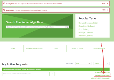

Under https://support.ptc.com you'll have this link:
Do you have an active subscription with PTC (that includes a support contract)?

Oh yeah, where can I leave a ticket?
