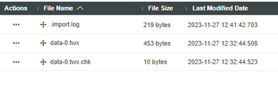

I tested the functionality with one stream and increased the read and write timeout to 30 seconds.
Backups show a file size of 453 bytes for the data-0.twx file.
Increase them to more than 30 seconds (60-120 etc, step by step). The data-0.twx is definitely small for 15k rows.

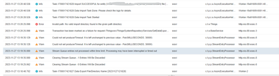

If you look in the Influx logs and ThingWorx Application Log, isn't there any error?
What version of Influx are you using?
I use influx OSS 2.7 in my EC2 instance.
Also, I can see some errors regarding stream queues.
