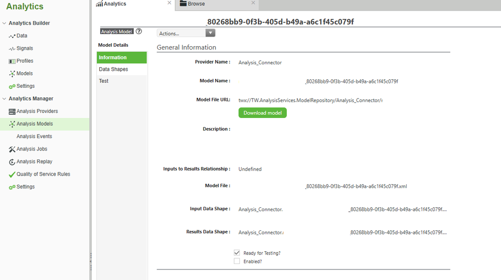

Trying to setup a new analysis model and having an issue with the Model File URL field. I am inputting my URL in the format /Thingworx/FileRepositories/<Repository Name>/<File Name>. It is giving this error popup however. Is there a different format to be used? Or a way to get the exact URL?
@JK_10744682 ,
The format for model URL is as follows: twx://<repository_folder_name>/<repository_sub_folder (if applicable)/<model_file>
Depending on which model you are talking about, you can obtain the URL by going into Analytics Manager > Select your desired Model > Click on View > Model Details > Information > Model File URL

@JK_10744682 ,
