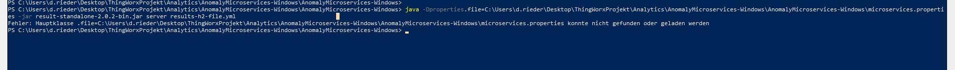

This is how it looks in powershell, the .file after -Dproperties is highlighted so I guess it recognizes it as a command parameter
cmorfin
(To:drieder)
Hi David
Could you execute the same command in a command prompt instead of a power shell.
I do get this error when I run in power shell, but it works for me in a command prompt.
Christophe
Hello Christophe,
thank you very much, running this in command prompt worked for me. I will keep in mind to always try both before asking questions.
