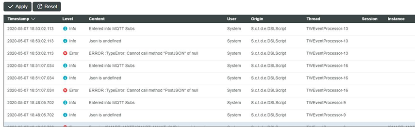

I have write the Logger in subscription and in POST service. please found below error-
Few error are like-
TypeError: Cannot call method "PostJSON" of null (MFM_TR01_TEST#42)]
:- MFM_TR01_TEST is POST JSON service.
Subscription error is-
Error Executing Event Handler 'X' for event Type.Thing:Entity."Y":Event.DataChange:Property."Z"
X- Logger name in subscription
Y- Thing name
z- Property name
It seems PostJSON is being called with null.

priyank
(To:priyank)
Please find above snap of error logs.
The issue is probably the one described in this article. System user is not having visibility to ThingworxPersistenceProvider
