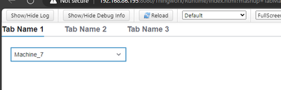

Regarding your ans. I am unable to add the mashup parameters. I have set up like below,
1) I have a Main mashup containing 3 tabs which redirects to 3 mashups.
2) On 1st mashup, I have Machine list, on selection display all selected machine details.
3) 2 and 3 mashup have related mashup to the first one.
I wanted to pass the machine name selected from 1 mashup to 2 and 3. I was unable to achieve this with the mashup parameter, Can you please suggest?

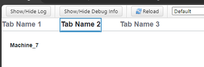

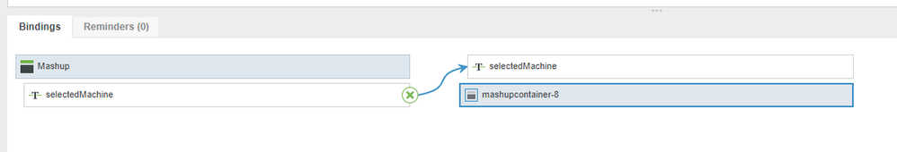

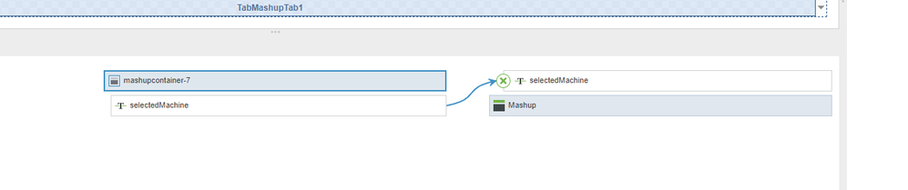

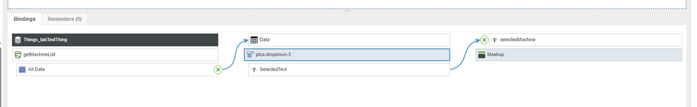

Hi @Vipul_Oswal
You have to create a Mashup Parameter in all 4 Mashups. And pass the selected value from Tab 1 to its Mashup Parameter
Bindings in Mashup 1
In the main Mashup, pass the value from Tab1 to the main Mashup Parameter

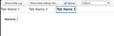

From the main mashup, pass the value to the remaining tabs contained mashup
The result should look like this
Please find attached entities for your reference.
